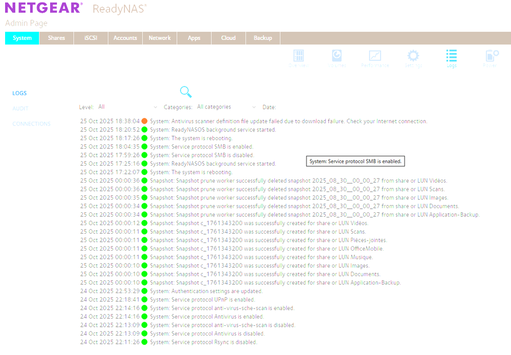

Since several days I had an unexpected disabling of my SMB on the ReadyNAS.
I'm trying to reactivate the service but each time the App button go back to grey status.

      I just saw the log from RN I saw just an error with the AV updating (it's a know issue from RN endlife  as I read)

      If the OS partition is too full, the warnings are in the main log you can view from the UI.
  • That is usually the result of a corrupted configuration file, and a typical cause for that is a too-full OS partition.  If that is the case, you'll see warnings about it in the log.  There are things that you can try (using SSH and the Linux command line) short of a full reset, but we need to know what's the root cause, if possible.  If the OS partition is too full, do not do an OS re-install -- it'll most likely make the problem worse.

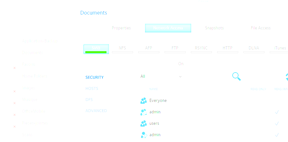

  • Very odd, I lost all shared accesses
    But I was able to restore them and activating the SMB from the shared folder
  • But the SMB service on the main page is still disabled :-(

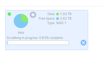

  • Sorry for this long waiting time, the Scrub is taking a very long time

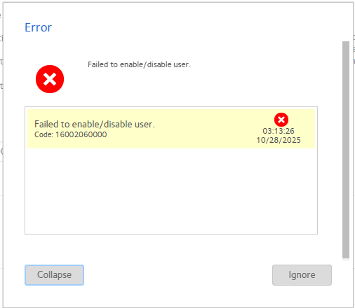

  • I have a new information over the SMB issue, when I'm trying to start the SMB service, an error pop-up is shown...
    • StephenB's avatar
      StephenB
      This is not an error I've seen before.
      Do you have any NAS user accounts that you are not using anymore?  If you do, then try deleting them.

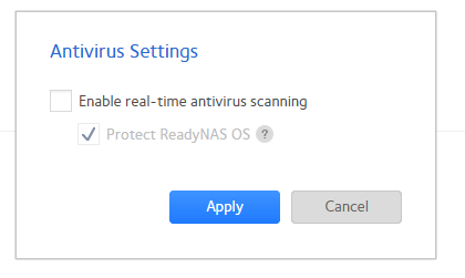

  • I did the factory reset, the SMB is back now, but I have odd behavior with AV. Also with my eSAta2USB-c, which I'm unable to connect an external disk, only on the USB ports
    • StephenB's avatar
      StephenB
      Can you give more details?

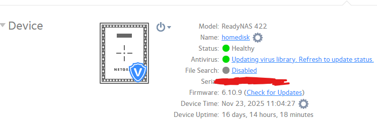

        Hi StephenB,
        Sorry for my very late reply, I tried a lot of trials before to send you feedback. I waited the second reply of Netgear support, but nothing total silent. Only one reply which I replied to answer their questions but now nothing from them.
        Many thanks for your help. So The AV can't start due to an unknown network issue detailled in the log, all internet systems work on my network...the Transmission app on my ReadyNas is working fine without problem.
        I'm very boring by the situation and the lack of reliability of Netgear. To stop my loosing time with them, I will buy a new NAS from a more reliable manufacturer. Maybe I will find a good deal with the black friday
