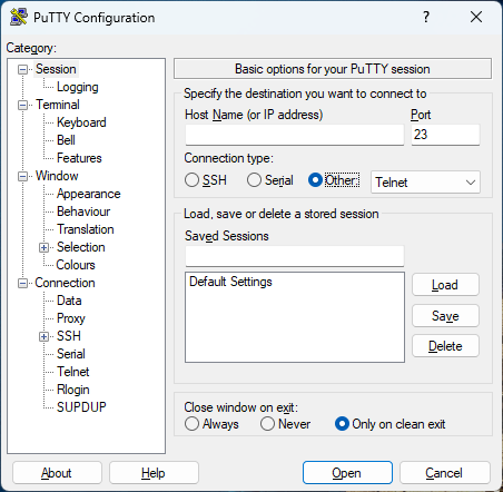

      also, do we specify a specific port when entering parameters in putty in order to telnet?
      Select "other" using the radio buttons, and select telnet in the pulldown on the right.  That will set also set the port correctly (to port 23).  Enter the IP address in the appropriate field.

      i enter the ip in telnet/putty, leave the port to the default shown, after hitting enter, the putty title bar with show the ip, but a dialogue box pops up saying connection timed out, which leads me to believe either its not in the correct mode, or the connection settings are incorrect
      Did you follow my instructions (using my screenshot as a guide)?  As I already said, you need to select "other" as the protocol choice, and then select Telnet from the pulldown.
