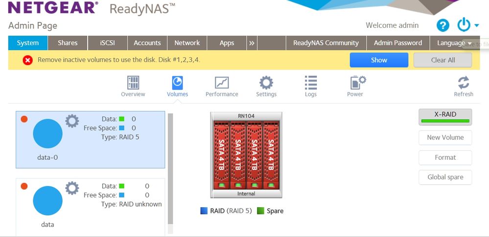

Initially got Page_address+8 error on LED. Power-cycled as no disk activity and now I just get:
Remove inactive volumes to use the disk. Disk #1,2,3,4
Volume: Resyncing started for Volume data
Volume: Volume data is resynced
LED display just shows NAS name and ip address

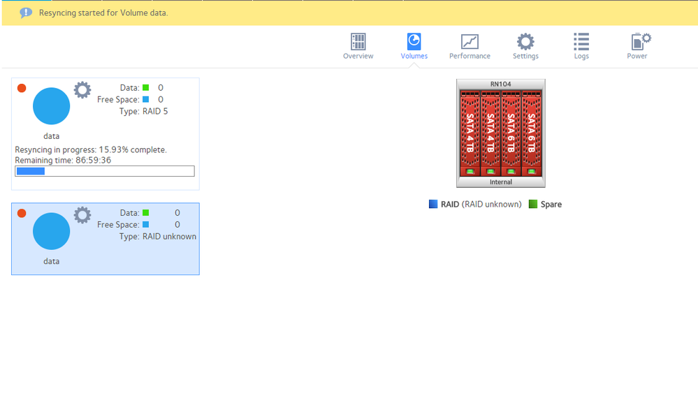

When I look at volumes it shows:
X-RAID
In the RN104 picture all disks shown as spare (green)
On the left it shows two volume pictures, the top has Data 0 and Free space 0 and RAID type 5 and shows resynch in progress 15.88% complete time remaining 57:55:04
The bottom shows Data 0, free space 0 RAID unknown
Shares are not available
Admin page periodically goes unavailable
Is this expected on inserting a new disk. Do I just leave it as it seems to be saying it will take 57 days to resolve.

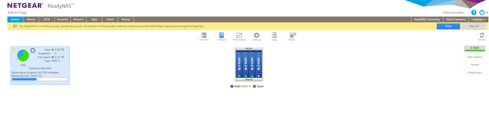

  • Appears has finished recovery. Looks like it has lost some data from pictures share but other than that back as was. Guess just needed to give it some time.

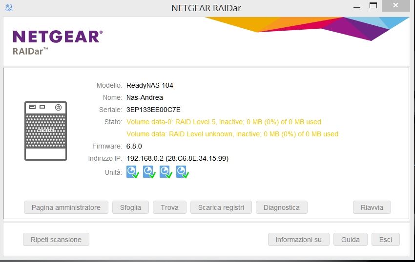

    I hade the same situation for my RN 104 but after more then 30 hourd of resync and around 50% of work done everything was stopped.  In the initial configuration I had 2 disk WD RED 4 TB in RAID 1 full of data and added 2 more empty disk of the same model.
    After the adding of the new disks started a resync process for countless hours and now the result is that no more data are avalaible on volume in the system. There are only one volume-0 RAID 5 with 0 MB and a volume RAID unknown with 0 MB!!  All 4 TB that were in the previous volume are not avalaible!
    Seem to me that the process to convert the previous 2 disk in RAID 1 to 4 disk in RAID 5 was failed and now the system is in a idle status with no possibility to make any progress.
    What can be done now to recover my data at least?!

        Hi froglet,
        I tried to shutdown and restart the system many time ... without result. Everything remained frozen as before.  So I was obliged to use the technical assistance by netgear ... it seems that they have solved the problem, the resync process restarted and now the situation look at least normal. I see my data in the volume first of all!!
        Afetr resync is completed I would be sure about the result but just now I now I have no lost my data!!   This is a wonderful news for me.

    Hello Froglet,
    Based on the screen shot you have provided there is no data save on the NAS and it going to a sync process but it will take 57 days to finish the sync process. I am not sure what may have cause this behavior but I would recommend, since there is no data yet on the NAS to perform and factory reset the reconfigure the NAS again. For guide on how to reset the NAS you may go here.

      Just to clarify, there was definately alot of data on the NAS before I inserted the new disk to expand its capacity.
      • Marty_M's avatar
        Marty_M
        NETGEAR Employee Retired
        Hello Froglet,
        Based on the screen shot there are 0 data and 0 free space and Resyncing is in progress, so I assumed that the there is no data save on the NAS. Since you have confirmed that you have data save on the NAS, I believe in order for us to address the concern this may require the NAS to be on telnet/tech support mode and seek assistance from engineers and/or higher tier who can remote in to the NAS and fix this from the backend. Unfortunately, It shows on your records that the support warranty of your product is already expired. You may try contacting support center and avail a support contract. That should allow you to extend the support for your product so they can escalate your issue to L3 or patiently wait for anyone in the community who has the knowledge in the SSH commands and fixing some issues from the backend.
