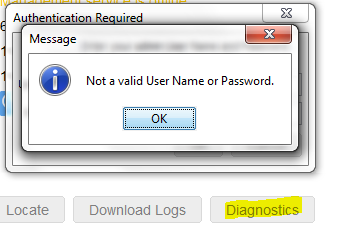

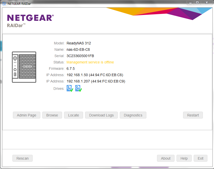

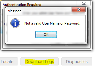

Data stored on our RN31200 has become inaccessible. Upon using RAIDar, I see that the "Management service is offline". I have tried the following in this order:
- Restart
- Reinstall OS
- Upgrade firmware using USB recovery
- Reinstall OS
Unfortunately, nothing has resolved our issues. I have also tried to download the logs and use RAIDar diagnostics, but the username and password is not accepted. I have tried both the default username and password along with our old username and password. Here are some screenshots:

- StephenBGuru - Experienced User
Are you still able to access the NAS data with SMB (for instance, entering \\192.168.1.50 in windows file manager)?
Also, what is the purpose of the second ethernet connection (192.168.1.207)? Is it connected to a different network?
Also, does https://192.168.1.50/fwbroker respond?
- JennCNETGEAR Employee Retired
Hello morelor,
Did you use admin for username and password for password after OS reinstall?
You may also try clearing browser cache the reopen the web browser. Also, unplug one of the LAN cables.
