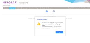

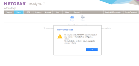

Hello there, I have an issue with my ReadyNAS104 Netgear. First I noticed that I couldn't access my data so I went to the admin page through Google Chrome. As soon as I open the tab I get a message saying this: "No volume exists. NETGEAR recommends that you create a volume before configuring others. Navigate to the System > Volumes page to create a volume". Of course I had my volume set long time ago since this is my data backup NAS. I navigate to System > Volume as the message ask me to do and I get a message there that says "Remove inactive volumes to use the disk. Disk #1,2,3,4." My volume data usage exceeded 80% of size, my NAS was alerting me that through email in case that is helpful to solve my issue. Please, can someone help me? There's tones of information in that device I need to keep safe. Thanks in advance.6.5KViews0likes15CommentsUser has been Auto deleted - all data lost
