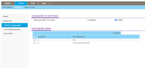

I need to pass multiple VLANS between a Cisco C9300 switch and a GS116EP. I've tried two brand new GS116EP switches, so it has to be an issue with the config. C9300 interface config: switchport trunk allowed vlan 1,10,20,30,40,50 switchport mode trunk switchport nonegotiate GS116EP config: port 1 is connected to the C9300 vlan 1 is untagged (C9300 native vlan ID) vlans 10,20,30,40,50 are tagged PVID is set to 1 The latest firmware version (2.0.0.5) has been installed. If I set corresponding C9300 interface to access mode, there's no issues. Trunking is the issue. What am I missing? Thank you for the help on this!Netgear Switch G5316v3
