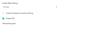

28 TopicsRS500 hidden advanced setting enables MLO
Not sure why Netgear chose to hide the advanced wireless settings revealed through the F12 browser display link mod. I can confirm that only the MLO setting works in my RS500 router when toggled ON, but the speeds seem to be worse with the Intel BE200 laptop wifi card with MLO enabled on the 5 and 6 Ghz bands. Edit: Can't attach screenshot...due to media upload in progress error.172Views0likes22CommentsRS500 router keeps falling back to 80 Mhz bandwidth from 160 Mhz
