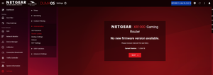

I have a XR1000 and my current firmware seems to be 1.0.64.18_5.0.19. On the support page for the XR1000 under 'Firmware and Software Downloads' it says "Firmware Version 1.0.2.86" with "Latest" next to it. https://www.netgear.com/support/product/xr1000#download Furthermore, I downloaded the XR1000-V1.0.2.86.zip, and when I extracted it, these are the files: -XR1000-V1.0.2.86_2.1.40.chk -XR1000-V1.0.2.86_Release_Notes.htm According to 'Nighthawk Pro Gaming Router Model XR1000' user manual on page 151 it says "Note: The correct firmware file uses an .img extension." .chk files are usually recovery fragment files What is the correct Firmware version and where can it be downloaded?49Views0likes5CommentsXR1000 Enabling VPN service stops internet / DNS from working.
