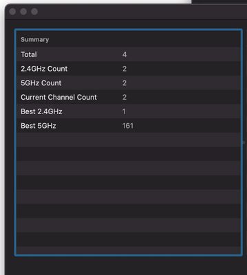

How do i know which channels are unused for 5ghz?
I ran this on my mac and it says that channel 161 is best for 5ghz, but the orbi only has 36,40,44,48.
Load up and install a wfi analyzer in a pad and you can check with this app to see whos using what.
WiFi Analyzer, Net Analyzer, NG WiFi Analytics, or Ubiquity's WiFiman are some apps to check out.

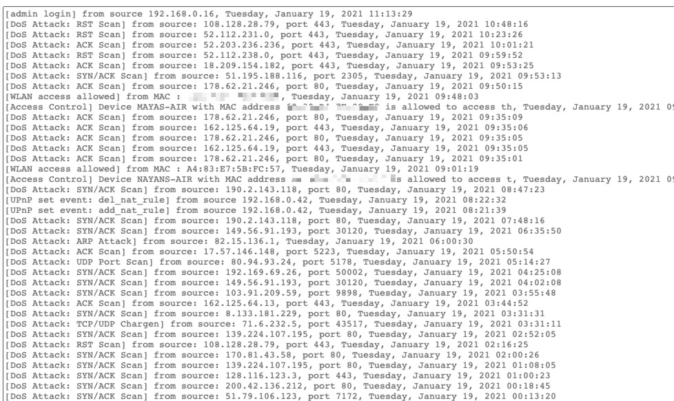

After making a raft of changes, the sattelite disconnects still, i logged into the control panel and looked at the logs, and noticed lots of DOS attacks around the time the sattelite disconected, is that a concidence? here is an image of the log
Looks like orbi reports normal behavious as a DOS attack.
Is there a way i can get access to the sattellite log files? (do any exist?)
