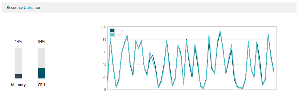

- chibikegeekAspirant
This is happening to me as well.
Dual NETGEAR 1200s > TP-Link Omada > TP-Link Archer A10.
The Details:
Firmware Version: EC25AFFDR07A09M4G
App Version: NTG9X07C_20.06.09.00 Web
App Version: LM1200-HDATA_03.03.103.201
Hardware Version: 1.0
View from the Omada attached.
Peaks correspond to LINK DOWN, valleys to +/- 30 from LINK UP
- JohnPengNETGEAR Expert
The Details:
Could you please confirm which carrier's SIM you are using, Verizon?
Thanks
