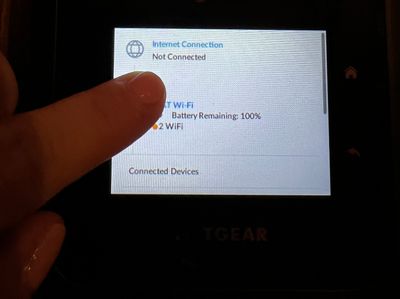

I have a new MR6500 purchased domestically in the States, factory unlocked per my eBay seller. I travel quite a bit abroad and have a norwegian Data Sim with Chilimobil (using Telia's networks) and while the device connects to the network (It says Chilimobil 4G LTE and shows signal bars 4/5) - it says "Mobile Broadband Disconnected" and when checking the Internet Map settings it says Internet "Not Connected"
Tried/Tested:
-The Sim is Unlocked with pin code (in fact, I deactivated Sim security because it got annoying).
-popped the data sim into my phone and confirm it connects just fine on an iPhone, so it is clearly a router issue
-factory reset didn't do anything helpful
-international and domestic roaming ON
Any insight one can provide on taking these things abroad would be most helpful.
FWIW, I tried calling Chilimobil customer service and they couldn't figure out why it would not connect to the internet either.
