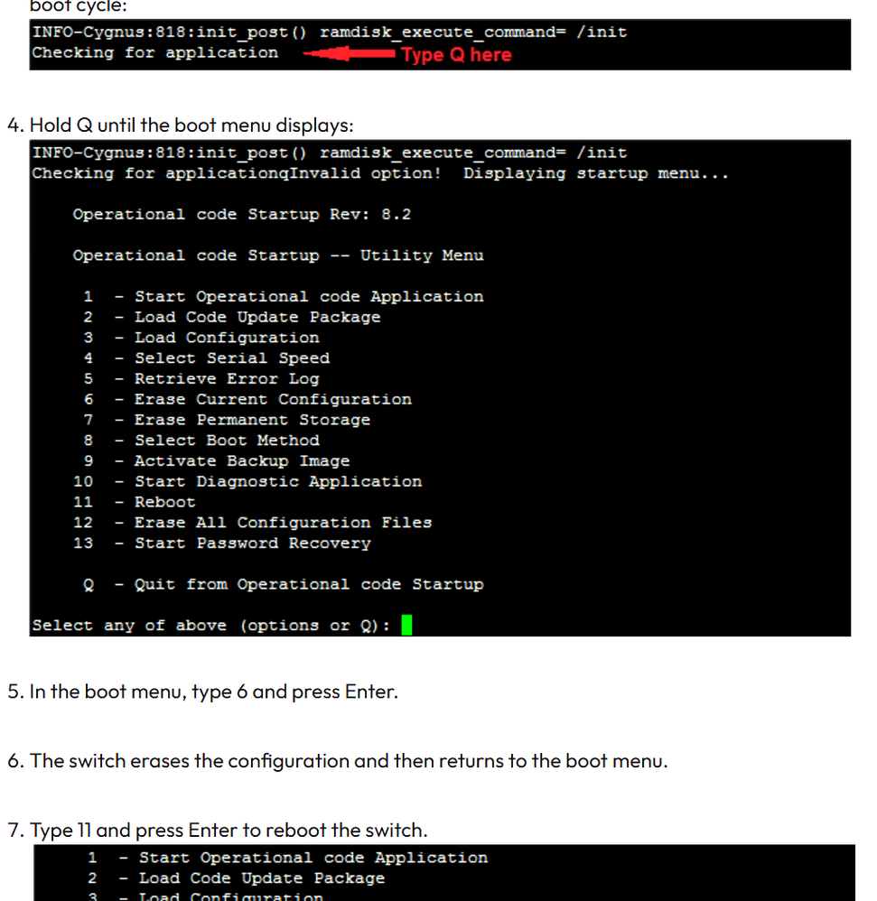

    This is the formal way - permitting the serial console remains workable, and the switch isn't completely dead - you have to break the boot process to get access to the boot menu:
    M4300 Resetting to factory default using the boot menu
    The "trick" breaking the boot process is nicely documented - press and hold the Q key ...

        Why ever. Strictly following the https://kb.netgear.com/30329/M4300-Resetting-to-factory-default-the-boot-menu would have saved a lot of time and effort. It's not difficult at all - just do it:
