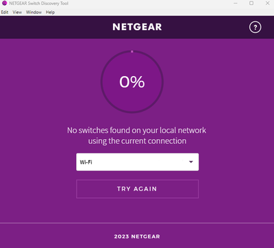

  • Just happened to me on MS510TX, https login successful but only partial webui load. Some panels showing connection refused test instead. Logged out, power cycled, and now Chrome gives:
    This site can’t be reached
    192... refused to connect.
    ..and Firefox gives:
    Unable to connect
    An error occurred during a connection to 192...
    Tried ssh and recieved:
    ssh: connect to host 192... port 22: Connection refused
    Should I factory reset? ..what a pain..
