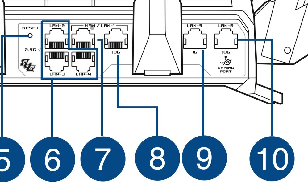

Hello. I have the switcher XS508M its LAN Port 1 is connected to the Lan Port 10G port of my router GT-BE98 Pro, and the NUC is connected to LAN Port 2 of the XS508M in other words, in switch XS508M the LAN port 1the router 10G lan Port of my router and in the XS508M LAN port 2 the NUC, when I use fast.com via I have speeds of 400 mbps around, and if I connect directly the NUC to the router to Port 10G, skipping totally the switch I have speeds of 600-900 mbps totally much better. Why if is supposed the XS508M supports 10G ports I have such speeds when browsing or in transfers? As this other similar devices. For example in one MYQ Garage opener if I connect to the Switch simply is not recognized I need to plug directly to the router to work.
But mainly what I would ike to know is why the speed issue or how can I fix or configure in any place something to improve this? Or why happens this?

    Be sure that the switch is connected to port# 6 on the router as that seems to be the 10Gb LAN port for your router.

  • I forgot to mention that yes this router has the LAN 1 and LAN 6 as 10Gb. Tested on both and the same but even in a 2.5 port should behave better, at least as the router direct connection with the NUC or whatever.
