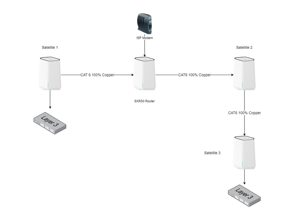

      1. I generally use insight but have also logged in through the routers page for troubleshooting and setting up VLAN's and ports.
      2. It would have been Firmware Version 4.3.0.140 which was the firmware immediately before the current installed firmware.
      3. Ignore the arrow heads, just doing a quick diagram for you to see.
