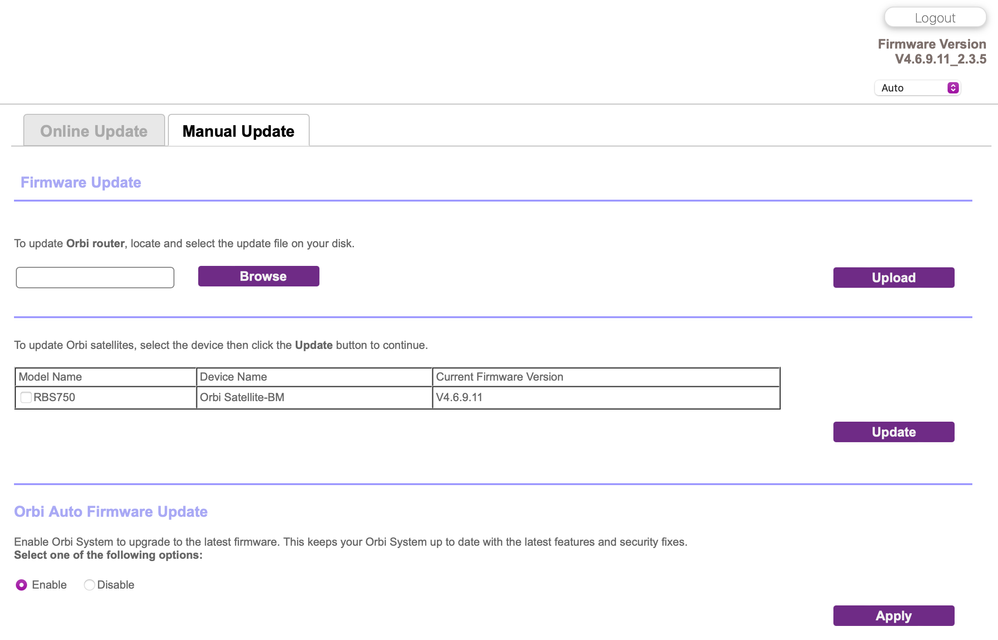

- AndyKHTutor
Hi,
Thank you for this information,
I have RBK857 system - RBR850 with six RBS850
Can I / should I update all satellites at the same time or is it one by one?
When I read 'how to update' it seems to assume one RBS unit.
Then update the RBR unit.
Thank you for your assistance,
Andy.
I can have the RBS web pages all open at once pre-stage, navigate to the RBS FW file on each page, do same thing on the RBRs manual FW update page. Then Send the RBS file one on each after the file gets up loaded. I usually wait to see the upgrade % circle to appear on each of the RBS web pages, once I see that, I send the RBRs FW file. If you want to do that. Mostly one at a time with each RBS first then the RBR lastly.

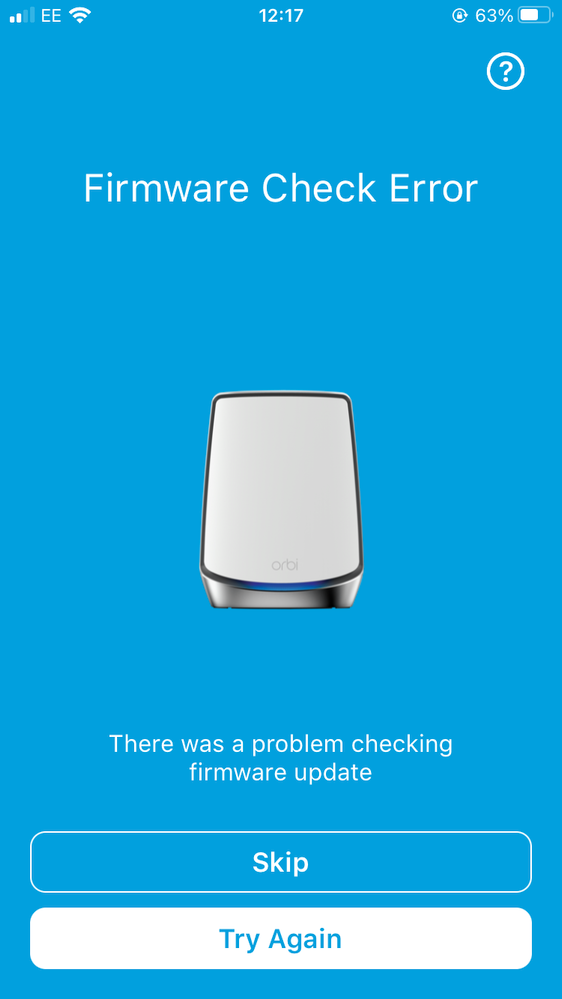

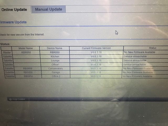

I need a bit of help!
Currently all ORBI devices are v4.6.3.16 (Router + 6 Sat)
From orbi app (v2.19.1.3) I get a firmware update issue please try again/later or words to that effect
From orbi login the 'auto' page says either 'no new firmware available' (Route +3xSat) or 'service unreachable' (3xsat)
manual updates, downloaded latest files , unzipped but when I 'upload' I get 'firmware upgrade failed. please try later' - This is when uploading the firmware file (not the next step of upgrading devices).
I have used 2 different unzip programmes, and downloaded from Netgear several times.
Any thoughts / suggestion please ?
This is laptop directly wired to Orbi router, wifi on laptop off, power not battery, chrome web page. VPN off.
Thank you,
Andy.
- Eriksen76ApprenticeI upgraded manually. First sat1, then sat2 and lastly router. Then finally a power off on all 3 units and my Internet box. Then I switched on all units one after one. Starting with Internet box, router and lastly sattelites. No problems so far, everything went flawless.

Then the mess began. All of my satellites disappeared from my network map. Went straight to the computer to check, and all satellites showed as disconnected. Logged directly into one of the satellites and, of course, different firmware version. Ok, no problem, I will update the 3 satellites manually, which I did. All satellites came back up fine, blue light etc. and were serving internet just fine.
Return to admin GUI and still all satellites show disconnected (but seem to be still working, although no longer show as part of the network). Ok, so let’s try resetting one of the sats to factory and re-adding the satellite. So I paperclip one of the RBS850’s and it gets weirder - 7 seconds and no amber flashing but red flashing - but satellite seems to have reset as password has reverted to default. Try to now add new satellite to the router but it fails, cannot sync the satellite.
Now at the point where I am not sure what to do. System ‘seems to be working’ although it says things are wrong. So leave it alone. Or revert back to previous firmware and hope for best, or reset everything to factory and start again…
Any advise on best direction gladly appreciated !
