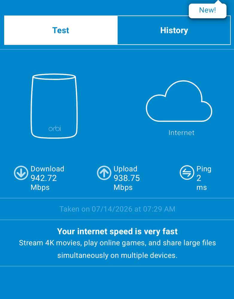

Has this happen to anybody else where the ping is so high on the rbr but the satellites have the correct ping ? my speed test is terrible on the main router but on the satellites its ok, this happens after the new update.

      So I have 1gb up and down and this is what I get I have less than 40connected use to work fine before the update. I did a reset of the router same thing.

    • FURRYe38's avatar
      Seems to be getting to spec speeds with Orbi app thru the RBR...
      • HappyCat's avatar
        HappyCat
        Virtuoso
        Thanks for taking the time to record and post the Speed Test results from the router.  This does seem to indicate that the issue is related to the WiFi connection of this specific device.
