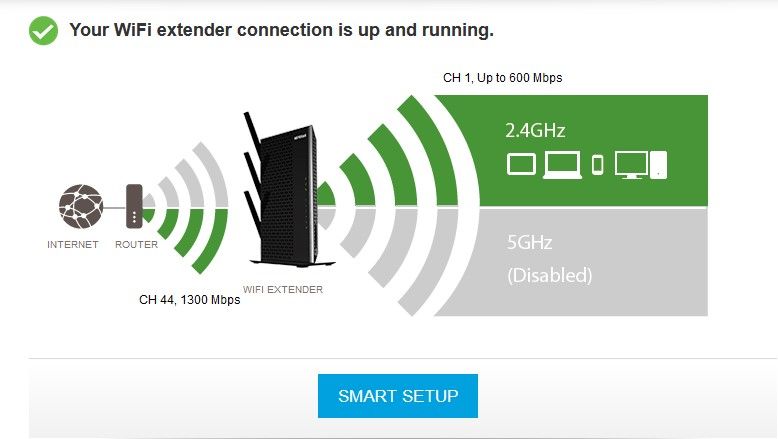

  • Ok. I installed the latest firmware but it has a issue and that is I cannot choose Fast Lane 5Ghz to 2.5Ghz and 5Ghz. I do not know what happened but I do not like the 2.4 Ghz band and it is annoying. Anyone has the same problem?
    here is the picture with the settings I used to have.
    • Zalmoxis_12000's avatar
      Zalmoxis_12000
      Tutor
      Sorry i uploaded the wrong picture. Here it is the one I was talking about.
      • 168bill's avatar
        168bill
        Luminary
        Zalmoxis_12000  My understanding is that 'Fastlane' doesn't work the in the way that you want it to.
        From the EX7000 Manual:
        Boost Your Video Streaming
        Get the most out of your HD entertainment with FastLane technology. With FastLane technology, the extender connects to your router using one band and connects to your devices using another band. Because a band is dedicated to each function, performance is enhanced.
        If all your devices and your WiFi router support only the 2.4 GHz band, or all your devices and your WiFi router support only the 5 GHz band, do not enable FastLane Technology.
        When you enable FastLane Technology, two options are available:
        • Use the 2.4 GHz band to connect the extender to the WiFi devices and use the 5 GHz band to connect the extender to the WiFi router. Use this mode if your WiFi router supports the 5GHzband but the devices that you want to use for gaming and streaming support the 2.4 GHz band.
        • Use the 5 GHz band to connect the extender to the WiFi devices and use the 2.4 GHz band to connect the extender to the WiFi router. Use this mode if the devices that you want to use for gaming and streaming support the 5 GHz band but your WiFi router supports the 2.4GHzband.
        My setup is as follows using FastLane and it has worked without error ever since I installed the latest Firware version.
