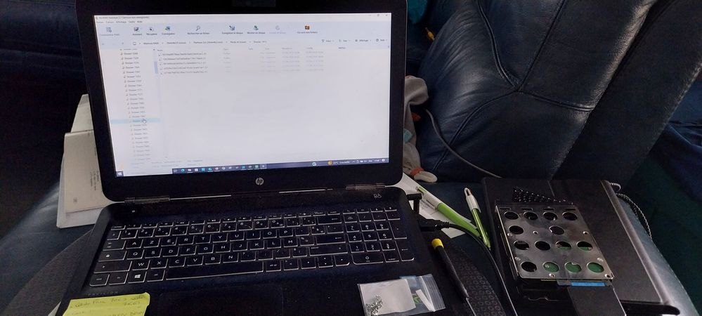

    • glooz1's avatar
      glooz1
      hello,

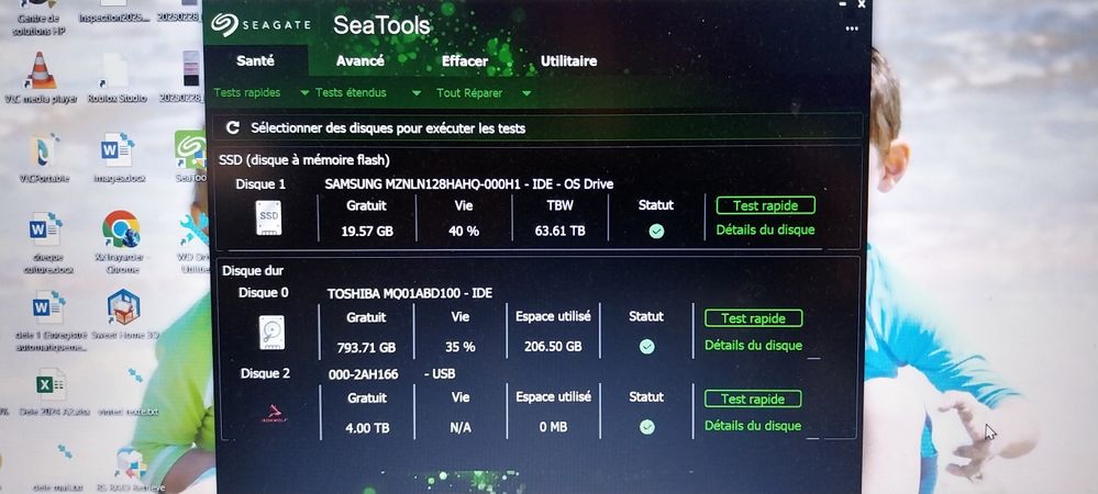

      I have checked disks 1 by 1 with Sata to USB  adapter. All disks starts properly. No electrical issue during the check.
      all the disks are OK using seatool from seagate. No error message.

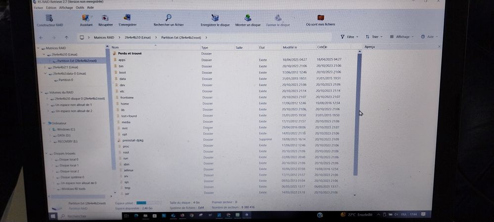

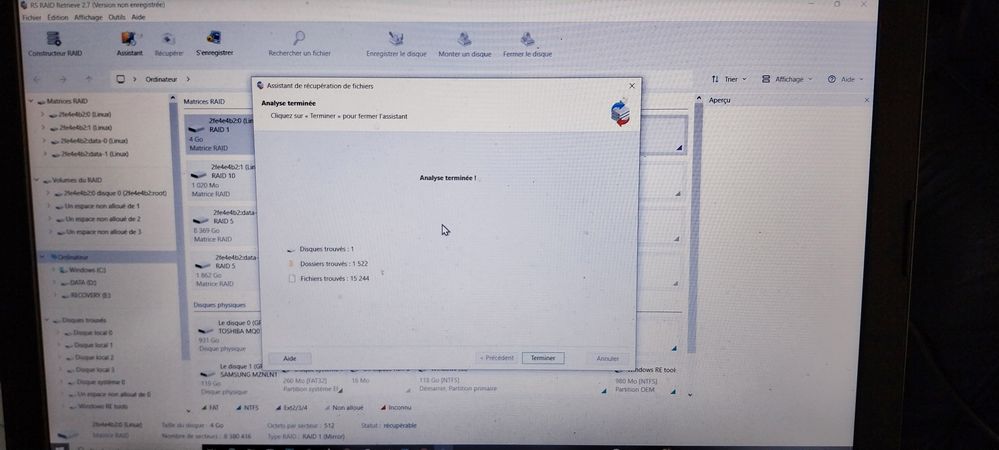

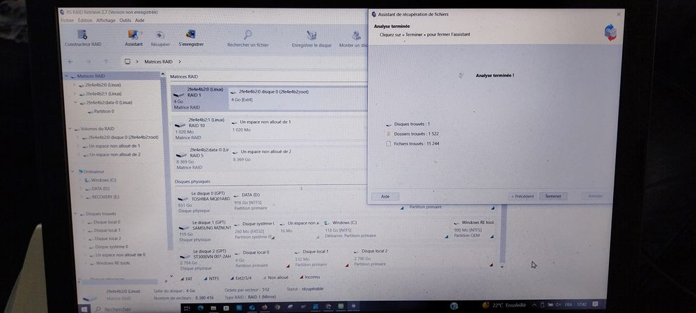

      I have also used rs raid retrieve software which is new for me. Below, kind of informations it gives. On the four disks i have this screen. The software find 15244 files for each disks tested. There is one difference i don't understand. On the first disk, image below, you can see 3 disks on matrices RAID but when i analyzed the 3 other disks rs raid retrieve found 4 disks !!
      disk 1 on RAIDdisk 4 on RAID

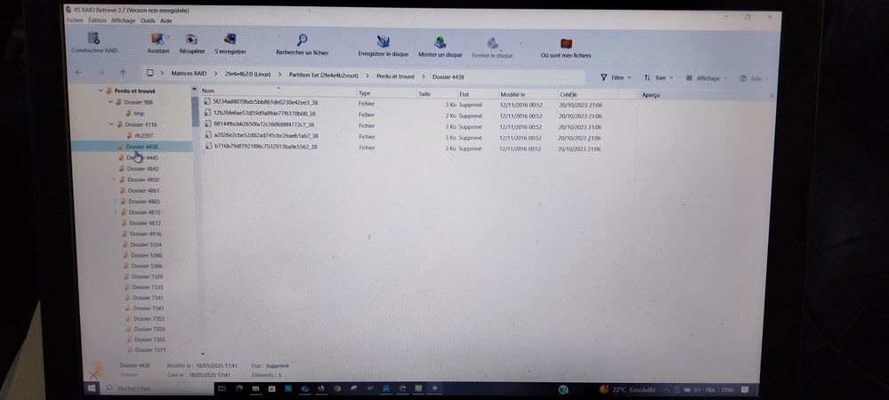

      rs raid retrive exploring the disk i don't find my files for example pictures or films etc
      files retrieve in one folder.... other folders have this kind of files but no jpeg or mp4
        Did you run the full test?  Or just the rapid one?
        There are multiple RAID arrays on the disks.  You appear to be looking at the OS partition (a 4 gb volume), and not the data volume.
        Data offload with RAID recovery software will require that you connect all the disks to the PC, not just one at a time.
        Aslo it will require that you use recovery software that supports the BTRFS file system.  The OS partition is EXT, but the data volume is BTRFS.
  • glooz1 wrote:
    Other item, do you know why with rs raid retrieve, when i check the first disk, it finds 3 disks on the raid and not 4 disks?
    I see in your Seatools screen shots that you have both 3TB and 4TB drives.  If there is more than one 4TB, then they will have one more RAID than the 3TB.  That's how XRAID does vertical expansion.  I've never used that tool or ReclaiME, but from what I've read about ReclaiME, it will show the files on the multi-drive RAID(s) in demo mode once you have enough drives to assemble the RAID(s).  I would expect RS to do so as well.  But that means you'll need at least 3 drives or drive images available, but all 4 is better in case it needs to use the RAID to recover from any errors on one drive.
  • StephenB's avatar
    StephenB
    glooz1​ - this is quite possible.  If you have mixed size drives, the 4 TB drives will have 4 partitions, and there will be four RAID groups on them
    1. OS
    2. Swap
    3. 3 TB data RAID group
    4. 1 TB data RAID group
    The 3 TB drives would not have the fourth data RAID group.
    Of course this does depend on what the RS software is telling you.  Sandshark​ is thinking that it is NOT telling you how many disks are in the RAID group you selected.  Instead he is thinking that it IS telling you how many RAID groups are on the disk you selected.
