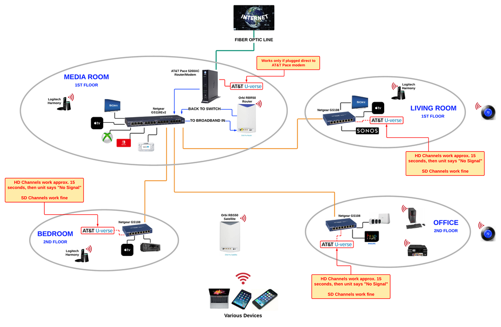

When connected through my Orbi RBK50, my AT&T Uverse cable is not working. Does anyone know how to get all Uverse receivers working properly with the Orbi router (NOT in AP mode) based on the setup below?
See Attached Network Map Diagram
  • If an AT&T receiver is connected directly to AT&T's Pace router/modem, the receiver works fine.
  • If an AT&T receiver is connected via my Orbi router, I'm able to watch SD channels however unable to watch any HD channels. The HD channels will come on for approx. 15 seconds, then lose signal and display the screen suggesting I reboot the receiver. After I reboot the receiver, the channel will come on for about 15 seconds again, then lose signal.
 I CANNOT run Orbi in AP mode. Using Circle Go to manage our kid's devices is a key reason I selected the Orbi vs a different mesh system.
I have 4 AT&T Uverse receivers located in 4 different rooms throughout our 2-story home. The AT&T fiber optic line comes into the house via our 1st Floor Media Room to an AT&T Pace 5268AC router/modem. The AT&T router/modem connects to a Netgear GS116Ev2 switch. From this switch I connect to the Orbi router, which then connects back to the switch. This switch then distributes to the rest of my home network, connecting to a Netgear GS108 in each room (1st Floor Living Room, 2nd Floor Bedroom, 2nd Floor Office).
Each room has various devices - TV's, Apple TV, gaming devices, Philips Hue, etc. Within each room is a Uverse receiver. Because of this setup, except for the Media Room where AT&T's fiber comes in...it's impossible to connect the Uverse boxes directly to the AT&T Pace router/modem.
The problem is NOT that I'm set up this way. Prior to getting Orbi, the Pace router/modem was connected directly to the Netgear switch in the Media Room, then distributed to the Netgear switches throughout the house (Pace->Switch 1->Switch 2->Uverse Receiver). Our Uverse cable receivers worked fine with that setup. It was introducing the Orbi that caused this issue.
Thanks for any help you can provide!!!

    Also what program did you use to create your network map?

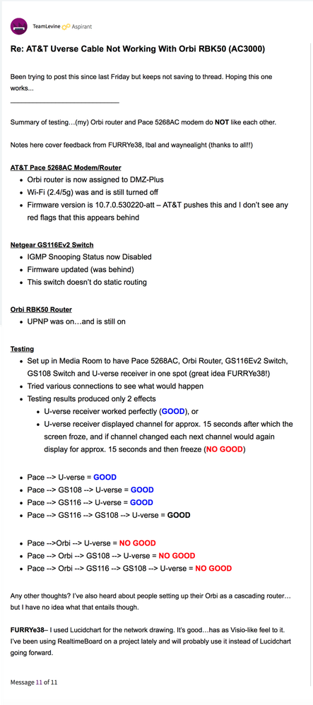

    • TeamLevine's avatar
      TeamLevine
      For whatever reason board hasn't been letting me post this reply. Been trying since last Friday. Seeing if posting as image works...
  • FURRYe38's avatar
    Try pasting plain text, no hyperlinks or embedded code...
    I see the picture as been approved...
  • FURRYe38's avatar
    Yes it is...
    So looking at what you sent me in a PM,
    • Pace -->Orbi --> U-verse = NO GOOD
    • Pace --> Orbi --> GS108 --> U-verse = NO GOOD
    This is is bad. Either way these should be working thru the Orib.
    You can try this:
    Pace -->Orbi AP mode --> U-verse = ?
    Take the Orbi routers IP address out fo the DMZ on the PACE. Save settings and reboot everything.
    I presume if this still fails, you should make contact with NG support AND the mfr of this Uverse system your using. Ask them if they have encountered any problems or have any information on using there devices with a Orbi system in this kind of configuration. Show them your information you've posted here.

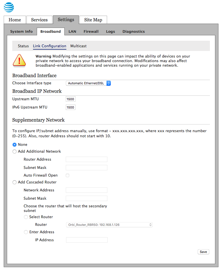

      Pace Configurations Review:
      FURRYe38 - I’m sending DM various screenshots of my Pace configuration. These are the configurations when Pace was set to DMZ-Plus to the Orbi as a router. If you wouldn’t mind reviewing them to see if anything sticks out as possibly incorrectly/inefficiently configured?
         Will check them out when the picture gets approved.
