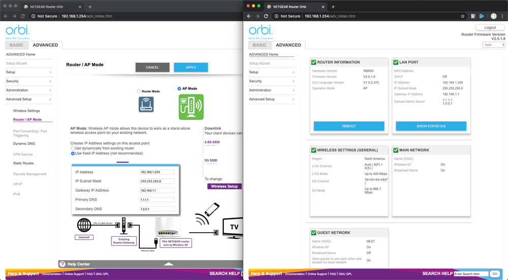

  • Delphimon,  This might not be specific to v2.5.18.  I had similar issues in the past with various firmware versions.  The solution that works best for my Orib setup is to put Orbi in AP mode, assign Orbi/Satellite reserved/static IP addresses, DNS servers, and let the ISP Modem Router or your private router handlles DHCP/DNS/Routing chores.  Orbi's strength is WiFi coverage and its backhaul.  If you have some spare cycles, give it a try.  Here is an example of my config.
    FWIW, v2.5.1.8 has been the most stable firmware released with the best performance to date for my setup.  YMMV.
