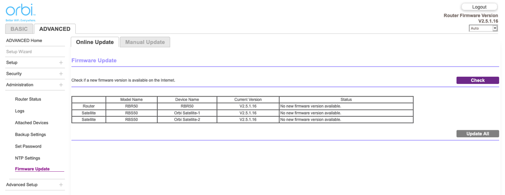

RBR50/RBS50 Firmware 2.5.1.16 Update
Latest firmware v2.5.1.16 on RBK53 in AP mode.  No new surprises yet.  Everything seems to be in order and working.  If you took the plunge, please share your experiences.
