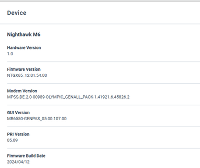

        The 6550 works perfectly without the battery using the OEM supplied power brick AND charging cable. That is at least how it is in my setup and own experience. I even have an extender so I can get it as close as I can to the window for a line of sight of the closest tower. I have a similarly designed Anker charger brick with the folding power plug blades. after a few months of use the blade prongs developed contact problems and now the brick had to held a certain way for the brick to stay powered on. I would be charging my phones only to come back the prongs acted up and my devices did not charge. I would certainly consider something with a fixed power prongs.
