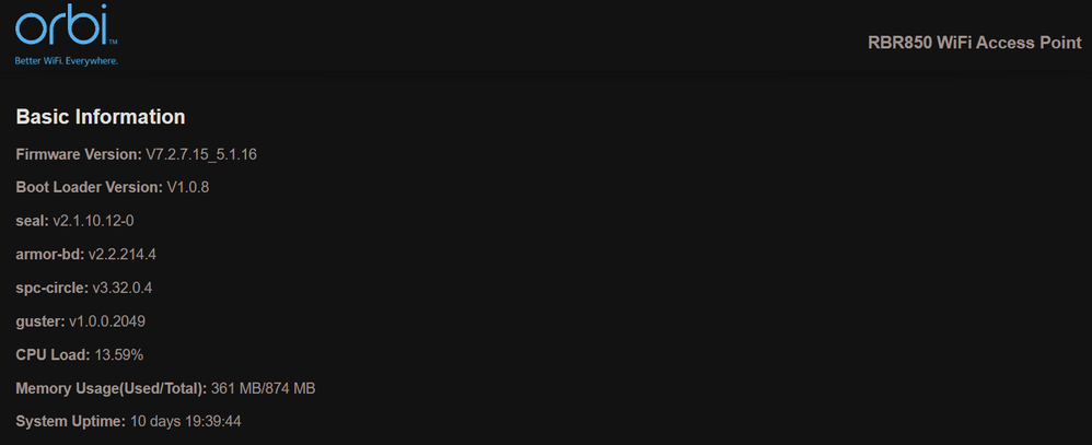

854 series working great on this version of FW:
- musicman0725Apprentice
This update has been working great on my RBR850 series. Updated the satellites first and then the router on Friday night. It has been running solid the entire weekend without needing to reboot.

I ran my 850 series for a solid 30+ days with out issues:
Though I manually loaded FW on mine first and then factory reset and setup from scratch. Good after that.
