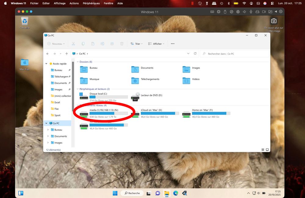

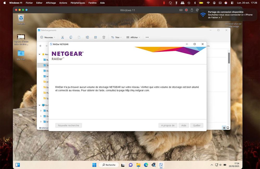

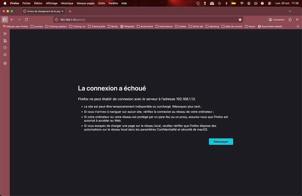

  • Here some screenshot
    On pic 1, you can see that I am able to mapped the drive and it is found on the local network (add some file)
    On pic 2, Raidar says "there is not Netgear devices on your local network""
    ON pic 3, Firefox  says "can not reach the address"
      Try powering down the NAS and then remove the two drives.  Label them by slot as you remove them.
      Power it back up and see if RAIDar finds it then.
      (If you reinsert the drives after this test, then be careful to do that with the NAS powered down).
  • Did not change anything with or without the drives. It is unexplainable, you can map the NAS as drive, add files but RAIDar can not see it.....

      Likely internet security or antivirus software on the PC is preventing RAIDar from finding the NAS.  Some of these packages block the broadcast packets which RAIDar uses to find the NAS.
      Are you still unable to access Frontview using Firefox ( with the change to security.tls.version.min )?
  • yes unable to access Frontview with security.tls.version.min at 1
    I tried with my antivirus (intego) off, still no access
      Is this using https://192.168.1.13/admin
      Did RAIDar give you any information with intego turned off?  (Also turn off the windows firewall if it is turned on).

        I abandoned....
        I turned off everything I can imagine (anti-virus, firewall, internet filtering...) nothing changed
        And then I remembered that I have a very old macbook in a drawer, took it and with this one, I can access Frontview.
        So I will use this low cheap solution, until I will buy a new NAS and copy everything on.
