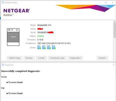

      Have you tried running the diagnostics from RAIDar?
      Ran the test.  Showing not any error.
