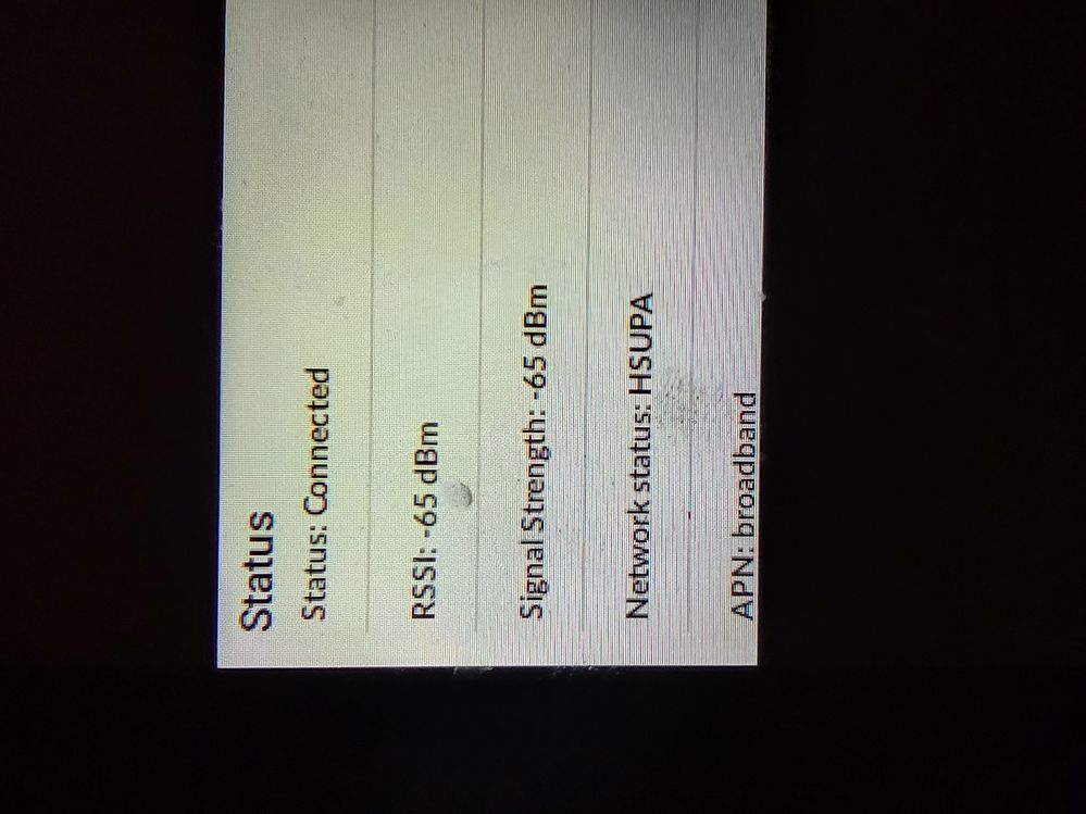

- steveXXXApprentice
Hello,
I have had my MR5200 for several weeks now and I LOVE it!
When it works, it works very well:
If I believe one of the apps on my phone, this is from a 100Mbps cell.
When working the status page shows:
Unfortunately anywhere from 10 minutes to several days it goes into this state, and the network no longer works:
Doing a "Reset" doesn't seem to clear it, but a complete "Shutdown" followed by a power cycle (10 seconds off) does.
tia,
Steve

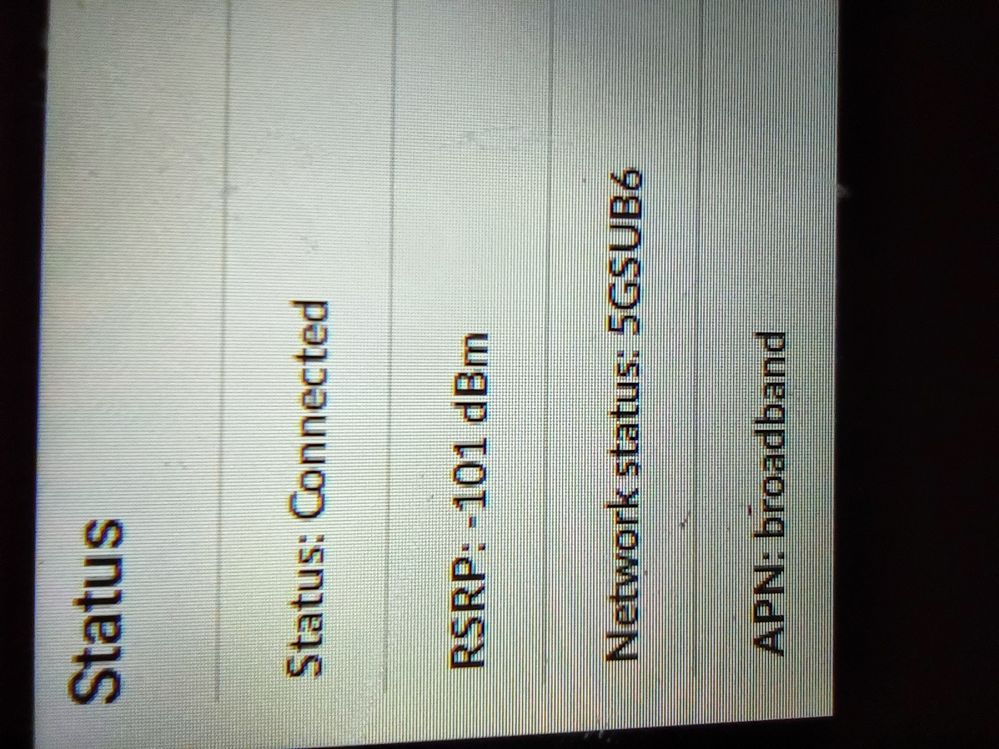

- JohnPengNETGEAR Expert
I can tell you are located at a cell edge based on the signal level shown on your device.
The device handover between 5G and WCDMA is controlled by the network based on the signal level reported by the device. You can try to move your device to find a better location.
In my home, I got the issue as you reported here. Power cycle or factory reset the device may make the device gets on 5G network. If the device falls back to WCDMA, it may stuck in 3G.
Please try set the device to LTA All in Badn Region and check whether you can get on LTE only network at your location.
Thanks

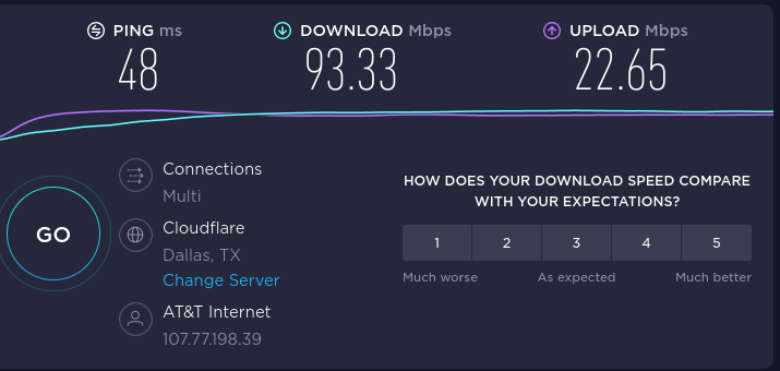

Did that, now see -95dBm and Network status: LTE
Thruput takes a big hit:
Guess its now a case of wait and see...

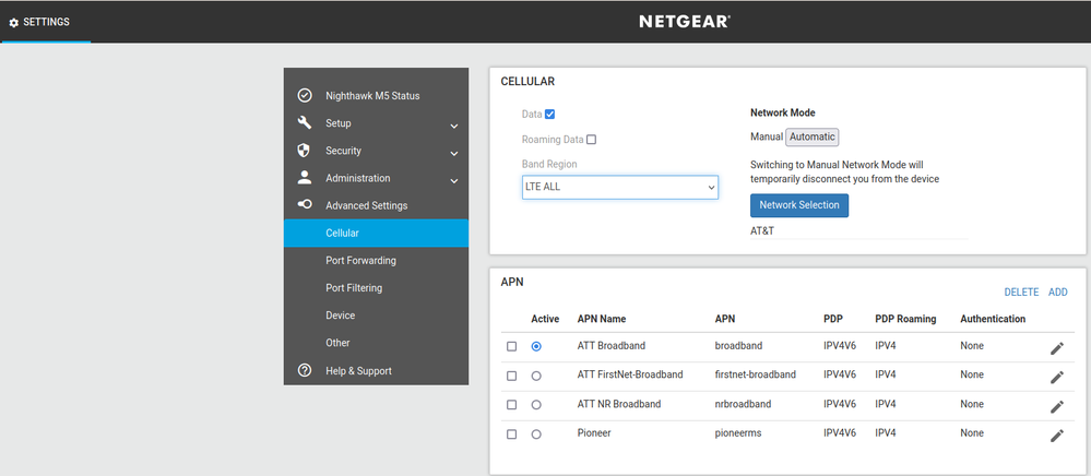

For MR5200, you can use TouchUI to set up the device or log in to WebUI to set up the device. You can refer to QSG for a quick reference.
The Nighthawk App is for Netgear Nighthawk router, which is not compatible with MR5200.
Please check you AT&T APN is set up correct. There are 3 options.
Broadband - For LTE plan
nrbroadband - For 5G plan
There is another one for FirstNet SIM. If you need it, I can help to check.
Please let me know if you have any other issues.
Thanks
