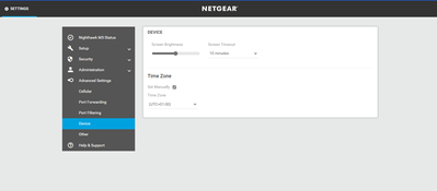

After doing some extensive playing around in all the settings!!! I turned on my Huawie's internal antenna (to keep it connected to 3's network - it's normally set to exclusively use the external antenna). I then plugged in the external antenna to the Netgear Nighthawk M5 and got the network connection back! I then plugged in an ethernet connection to my laptop and connected to the web page 192.168.1.1 and set the timezone manually and also set it to all bands, since the 4G signal seems to be dropping a lot with the device!
Now it seems to be connecting to the network after rebooting without the need for the external antenna to get it on the network!
It makes sense! since when I was working at a company that provided IT service to the Met Police, If your computer's clock was not correct, it would refuse your connection to the network!
It now seems to be working! It does still sometimes take a wile to connect but it's working much more reliably with the timezone set manually!- Interesting about the time, but why would using an external antenna override the time issue,

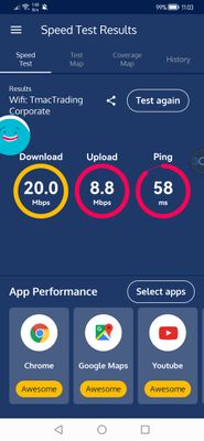

2 days in a row with no service for 12 hours only works with an external antenna! was able to get on with external antenna but now it seems it doesn't hold the connection after unplugging the antenna 😞
Also yesterday, I was testing it out and about and My phone is on 3's network and I had 4G and 4G+ almost the entire day (Inverness to Ben Wyvis carpark) No signal till after the Aultguish Inn where I got H+ Until I hit the Braemore Junction where I got 4G+ and then got H+ after Ardmair (no signal on most networks from Drumrunie to Achiltibuie. Had 4G in Achiltibui on 3 on my phone which is only 4G capable.
On the Netgear device which is on ID Mobile (which are using 3's Infrastructure, Smarty also are on 3's infrastructure)
5G from Inverness to North Kessock. 4G to halfway to Tore. H from there Dingwall roundabout then lost connection all the way after the Aultguish Inn where I had H No signal till I hit Ullapool where I got 5G After Ardmair got H up to the Drumrunie Junction then lost signal then Nothing at all at Achiltibuie.
I got back to inverness and had all but an Hour of 4G when I got home then it dropped the connection and wouldn't find the network again until I plugged in the External Antenna about half an hour ago. I then unplugged it and the signal bar stayed on 4G with 2 bars so I connected my laptop's ethernet to the port Netgear page loads up, I opened a tab which failed to connect and sure enough network icon on the laptop showed no internet. rebooted the M5... No connection (searching)

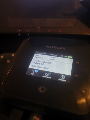

Ok I just rebooted my router a few times without the external antenna...
1st time it rebooted and searched then connected to 4G fine!
2nd time it rebooted and came back on searched said connected then went back to Searching. Weird thing is though, Laptop was still connected, and one drive was uploading files!
Connected my phone to its Wi-Fi and although the device is saying searching.... the data is working. There is also no yellow and black Exclamation sign on the screen saver screen saying data is turned off!This suggests that the issues with the latest firmware are:
Random Dropouts on the mobile network
Not Searching and / or connecting to the network, without the aid of an external antenna
Searching and finding the network but then falsely showing Searching while the data connection is fine:so, is the device doing speed tests of its own and refusing to connect to networks below a certain speed?
