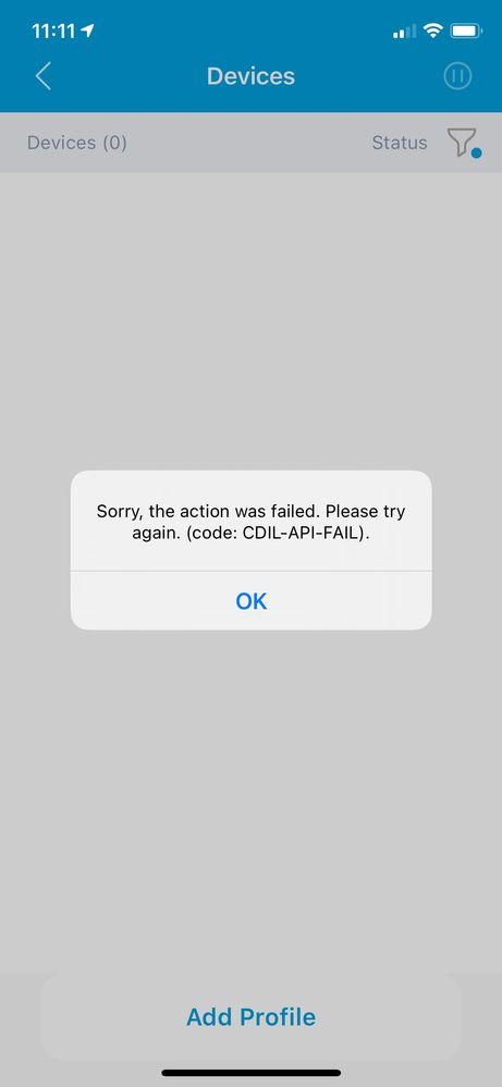

Orbi App Bug with Firmware 2.7.1.60
I updated to Orbi firmware 2.7.1.60 last night and now when I go to view the devices connected to the Orbi via the Orbi app I get the following error. This happens on both my iPad and iPhone so it seems to be something related directly to the new firmware. Has anyone else experienced this? I tried googling this error and absolutely nothing comes up for it. So it seems tobe fairly new and unique. Plus there is a typo in the error message which is strange.
The error is:
Sorry, the action was failed. Please try again. (code: CDIL-API-FAIL).
Orbi App Error

Updated a few hours ago, no problems. Booted app up and have same errors! Also seems like Access Control has disappeared from the web. Advanced > Security > Access Control tells me "To use Access Control, please use the Orbi App."

Updated to Iphone app version 2.7.0.28 on 11/16/2020. Still have the same problem accessing device information via the app on the Orbi system using firmware 2.7.1.60. Clicking on "Devices" results in a delay followed by "Could not reach server. Try again later (code: CDIL-API-FAIL). OK"

No devices shown at all on RBR50 (router) OR on any of the Satellites RBS50 and RBS20.

I have the same issue as well. Looks to be tied with security being enabled. For a brief period following a restart, devices were present. When Armor was loaded the devices disappeared and the cdil-app-fail message is displayed.

- rblockAspirantThat is correct. After I installed 2.7.1.60, Armour was automatically started without my intervention. I had to turn it off and now it has expired. Even when it was running, I was unable to access my devices through the app.

So, as some have mentioned, it might be Netgear Armor that is breaking it. Coincidentally my Netgear Armor expired a few days ago. So perhaps the fact that it is expired might have been the real fix for me.

I have found a solution re:Orbi iOS app not working with the new firmware update V2.7.1.60 I manually changed to the firmware V2.6.1.40. You can find it on the link: kb.netgear.com/000062484/RBR50-RBR50-Firmwar-Version-2-6-1-40 You also have to delete the Orbi app from your iPhone, then reinstall before connecting to the router after the firmware change. I have seen posts that the app worked only for a short time after the update to V2.7.1.60, but I have not had that problem. Changing to V2.6.1.40 does NOT seem to have the conflict with the iOS Orbi app. Hope it works for you!
