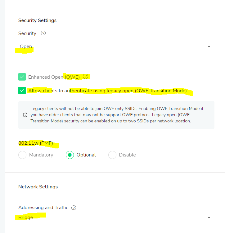

    While hard to imagine DHCP works, but the Internet access does not, please check the default settings for this SSID in regard to OWE, OWE Transition Mode, PMF, and the network mode is bridge (or NAT). Here how Insight does set such a password-free SSID:

      Thanks.  I upgraded the firmware from V9.6.0.7 to the newest-available, which is V10.6.0.7, but that did not resolve the issue.
      Based on your settings recommendations, I then enabled Enhanced Open, as well as Allow Devices to Connect with Open.  (Addressing and Traffic was already set to Bridge).  But changing these settings had no effect - laptops still connected with Internet, and smartphones still connected and got an IP assigned, but with no Internet.
