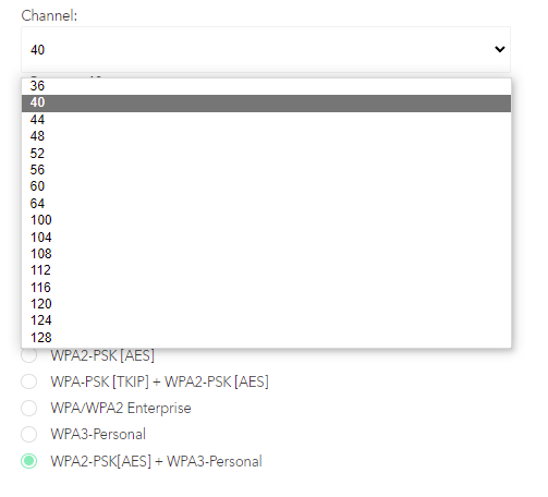

        2. I noticed that the higher 5Ghz channels are missing from the UI:

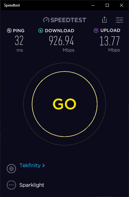

        3. Wired speed testing is good and to spec for my ISP services:
        4. Wireless on two different wifi client adapters is not to spec on the upload. Should be at 50Mbps. I'm not seeing that:

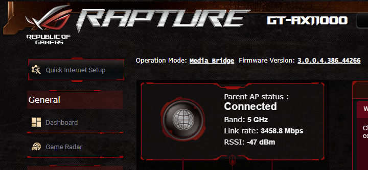

        Connection rate on my ASUS in wifi bridge mode is good:
        The ASUS has testing out on other routers and gets to spec speeds on the up so I know it's not the ASUS.
