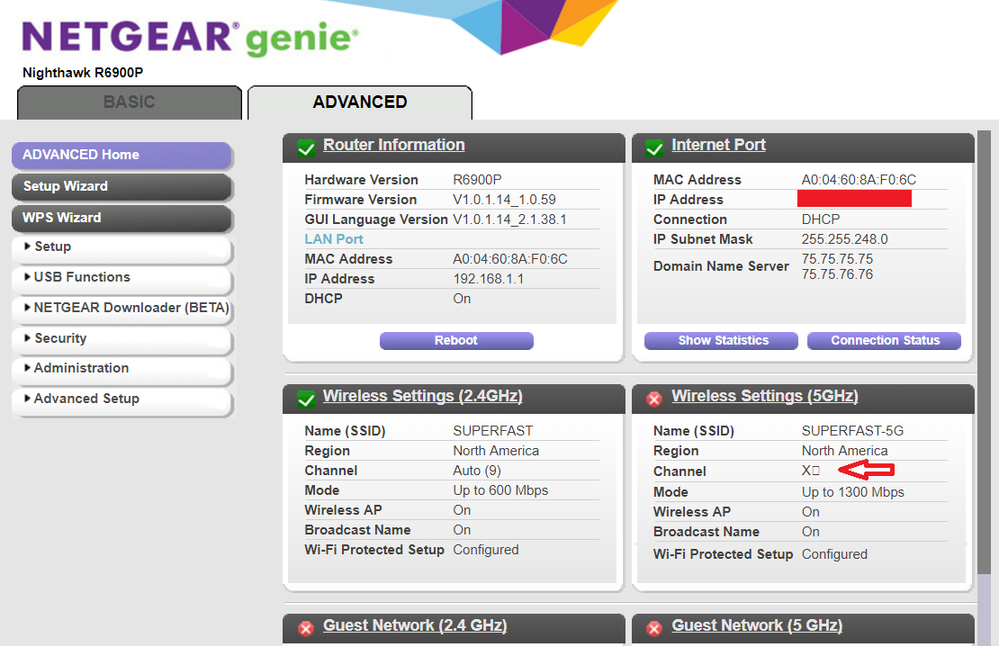

  • R6900p 5Ghz band crashed again, so changing the channel did not improve anything.  However, this time post-dropout some more garbage characters showed up on the status page of the router GUI.

      Update: enabling Smart Connect appears to make no difference, the 5Ghz drops out and gives garbage characters in the status page's channel information also.

        Update - returned it and got another R6900p from Costco.  This time, I left it on the default factory firmware without updating, same behavior with 5Ghz becoming unstable then unusable.  Updated firmware to latest version, no change in behavior.  Same problems with garbage characters showing up in channel information field on the router status screen.
